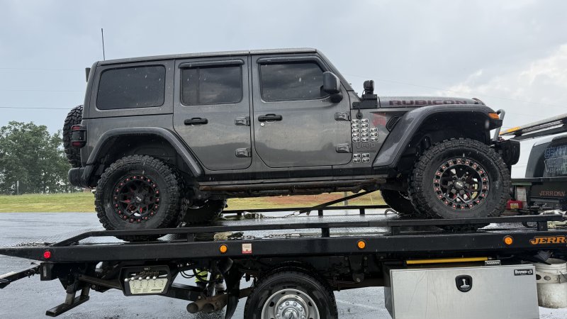

I’m waiting for wrecker then a co worker will give me a ride to the RV park where I’ll sit 😂" referrerpolicy="origin-when-cross-origin" src="https://static.xx.fbcdn.net/images/emoji.php/v9/td0/1/16/1f602.png">🤷‍♂️" referrerpolicy="origin-when-cross-origin" src="https://static.xx.fbcdn.net/images/emoji.php/v9/te5/1/16/1f937_200d_2642.png">

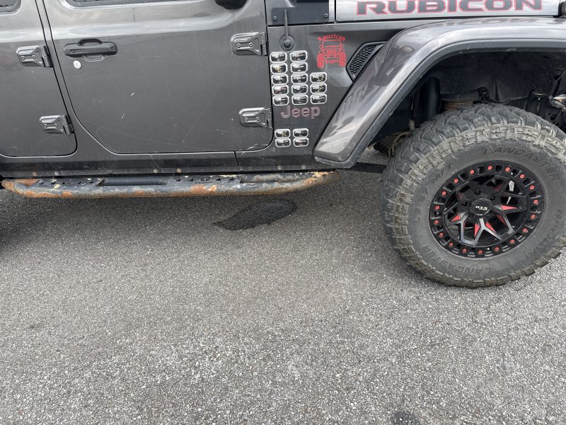

Here is side of jeep nothing looks wrong

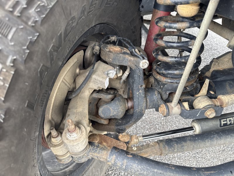

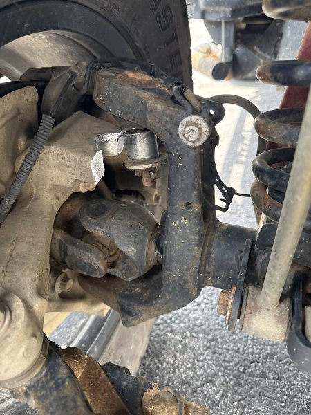

Here is after I drove 75 mph lol and decided my ocd with steering wheel off caused me to stop to hit the curb and force it back then I got out and saw this after 8 miles I might add
I love my metal cloak suspension…
