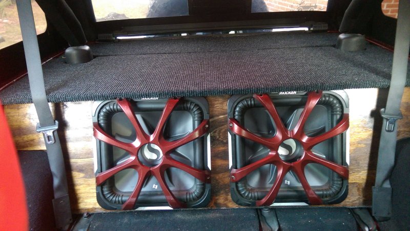

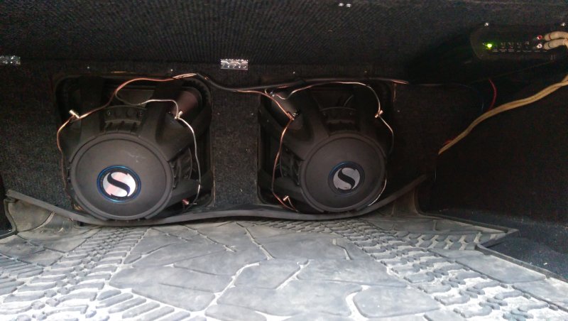

Then I made a custom speaker mount for twin L7 15"2000 watt ea subs...
May be a little much since I had to install and extra battery in trunk but space saving You could always build a single speaker box...

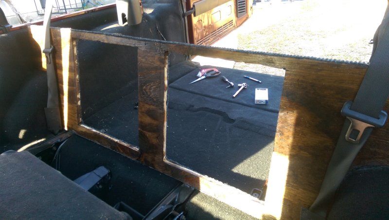

I also run a Tuffy secure enclosure so, I replaced the metal front facing panel with the wooden one pictured I used treated plywood then stained it and clear poly coated it...
and it still looks the same today...

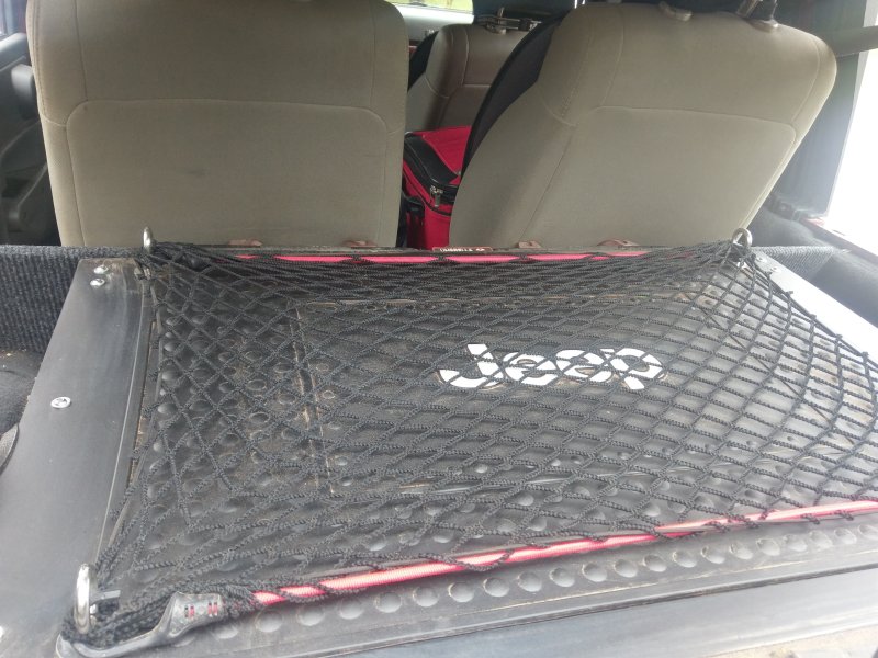

I also added a few cargo eye loops and net plus a back mat for a XJ I think
I spray adhesive applied All weather carpet to dampen the metal sounds that I anticipated Id have running the tuffy enclosure...
The great part is you cant remove the speakers without removing the enclosure unless you have the tailgate open...
