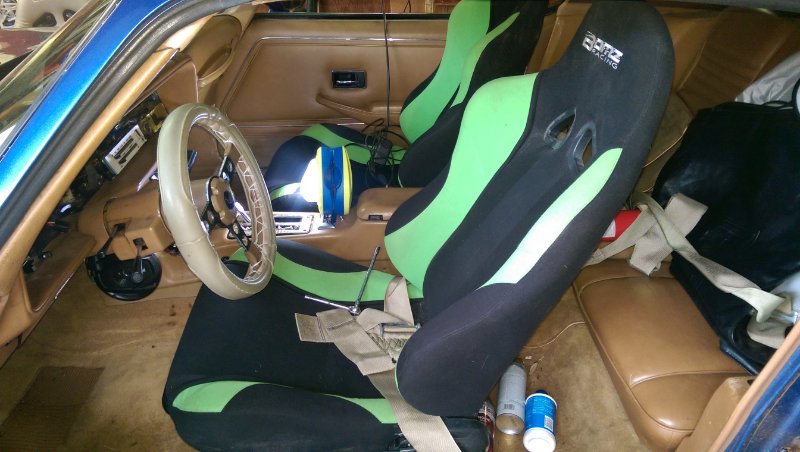

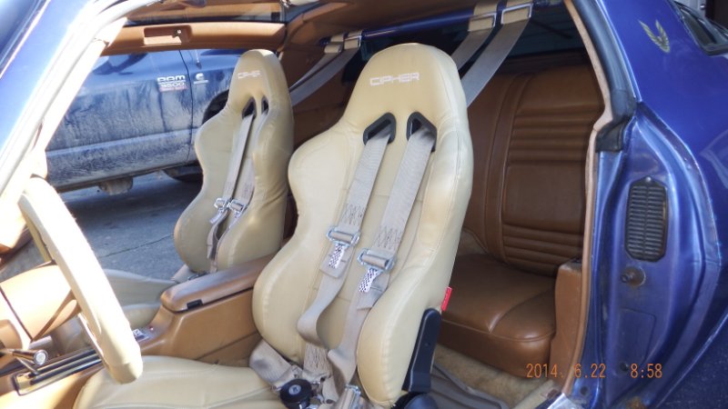

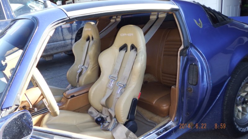

I opted for 4 way seat harnesses for my Trans Am I have not opted for them in my jeep...
I figure in my jeep the odds of me landing on the roof are greatly increased over the TA...
I also bought race quip harnesses and rear race cars run the same gear.

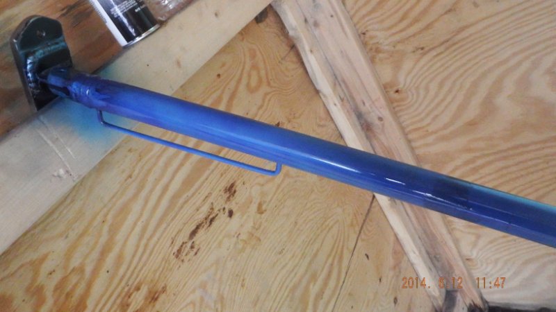

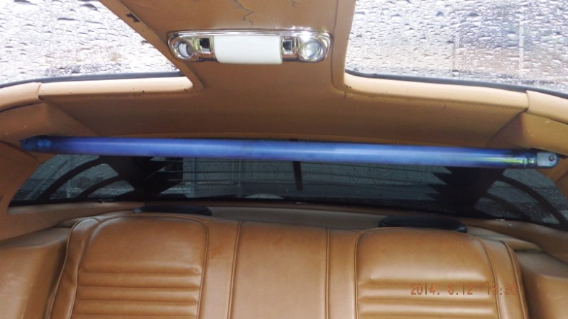

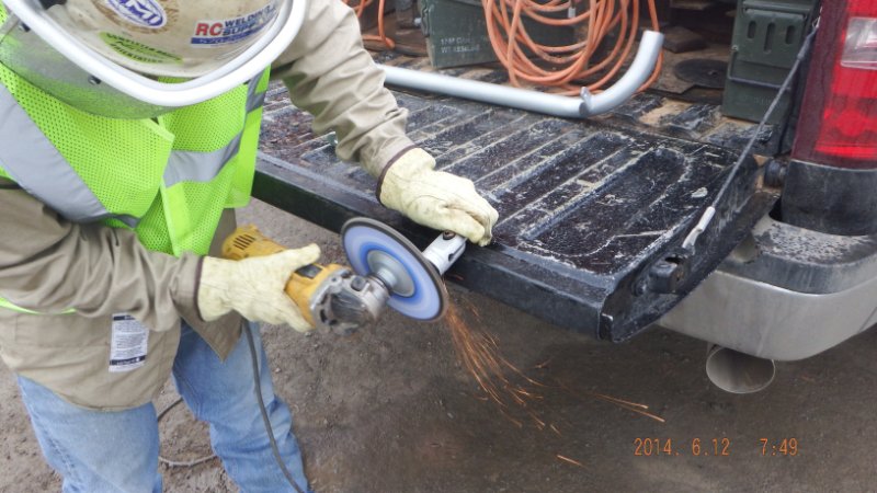

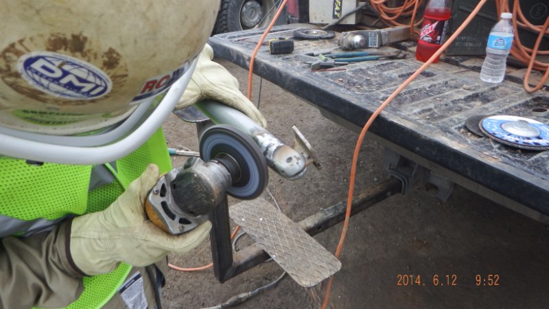

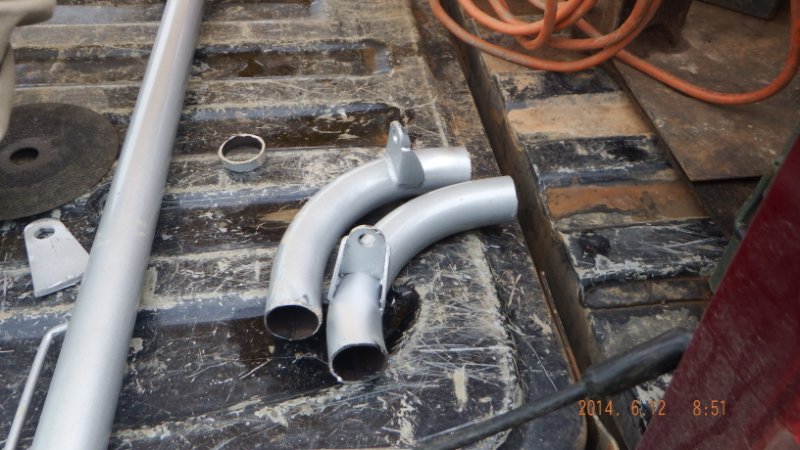

the rest Ill show ya know...for my particular set up I designed a different Harness bar and set of connections for the following reasons...
My seat belts were shit frayed old faded and looked like shit...
I decided I was getting new seats harness bar and belts...but not a cage...
I also figure I will ride slightly loosened but not where I can come out or anything...
Just not where I cant reach the dash like the first times when you harness up...lol

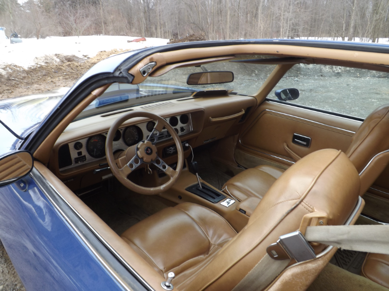

So Here we go factory seat belts...
Hell you can see a fray tear there now... you also can see the crease over time basically they arent safe...Im not stopping the run to the store until new ones come in but im hoping and planning my life doesnt depend on it either...

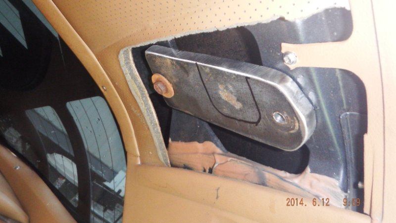

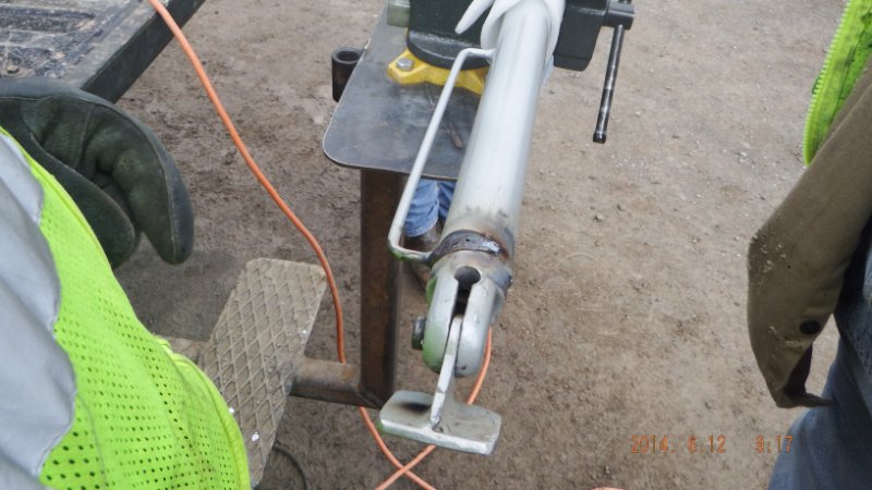

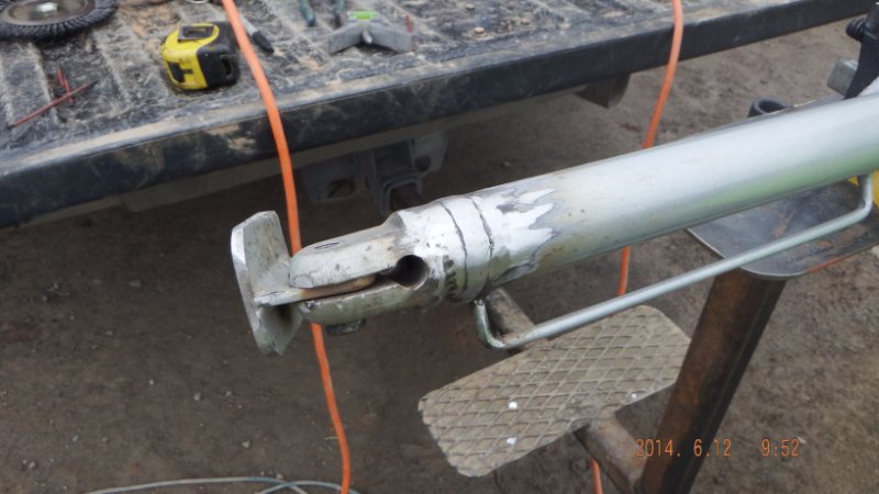

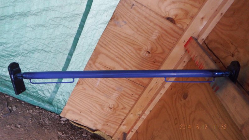

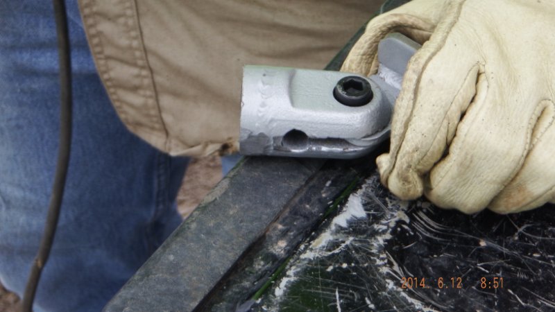

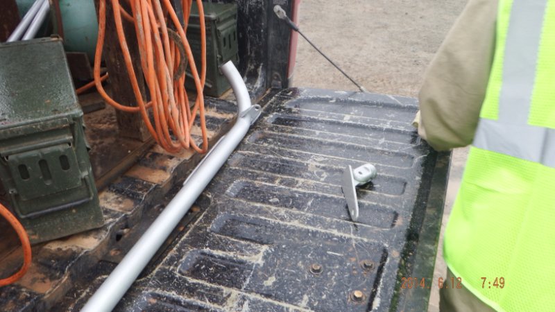

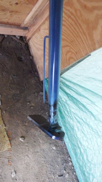

So now the harness bar...
So I paid like 152 for it somewhere. and everywhere I saw them mounted was on the back floorboard with the strap through the seat then straight down and I thought of submarine stuff. and I keep looking up thinking why not where my regular seat belts go... but how?
Plus I dont loose the use of the back seat and it also adds some strength to the T top section which I did pop one in the past for twisting up and the body went a little too far also...
