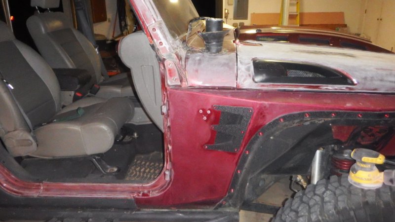

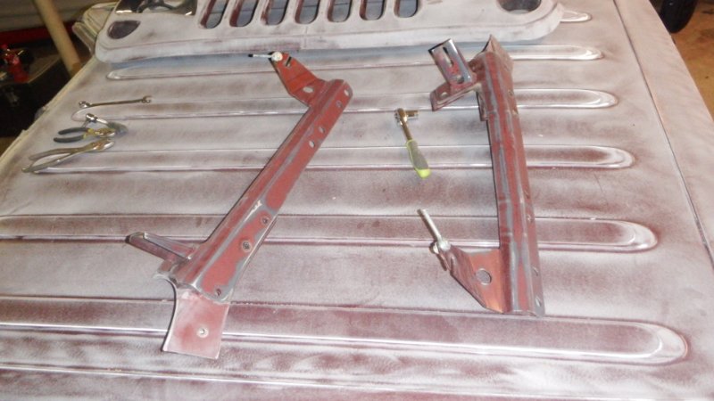

Self Application of Monsta Liner...and Prep...and more prep... and yet more prep....
Just when you thought you got it all ooops more Prep you missed...
See images...
We will pick this up down below a bit...

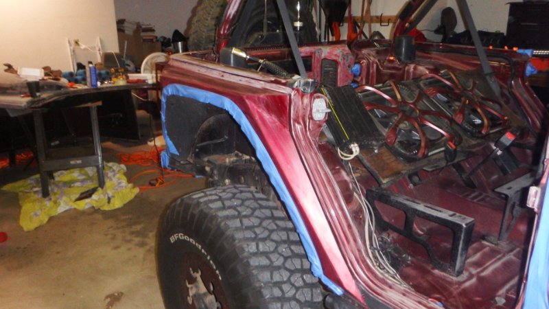

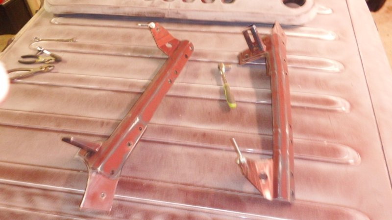

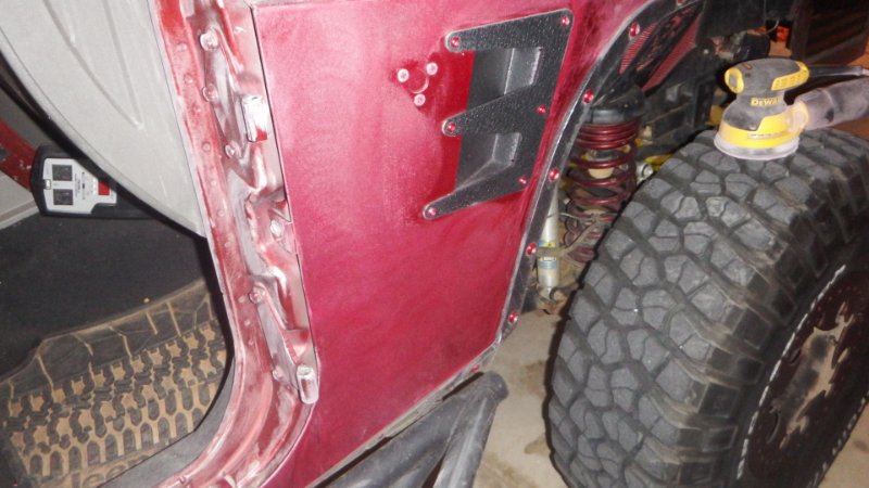

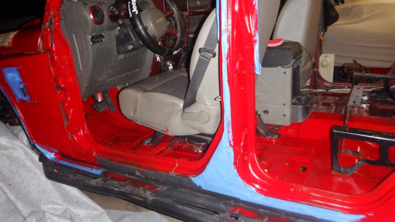

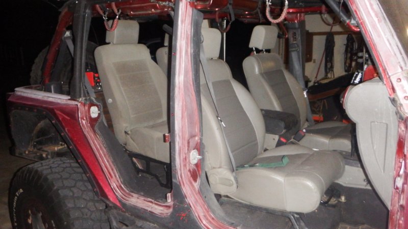

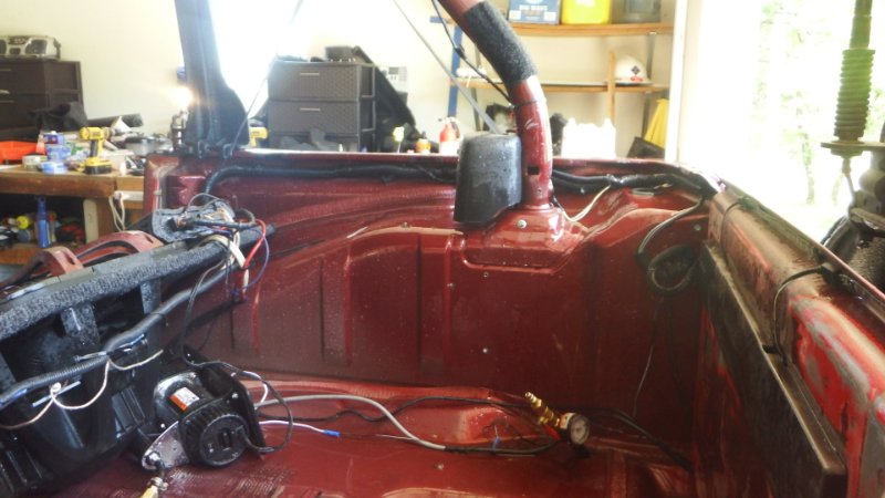

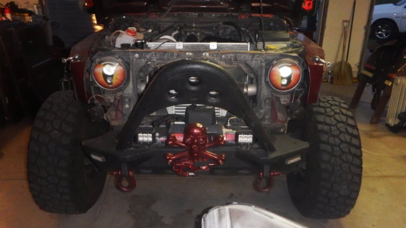

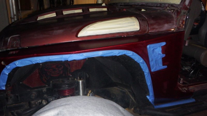

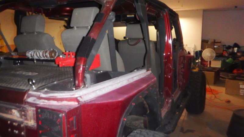

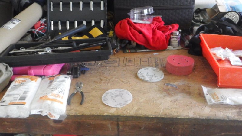

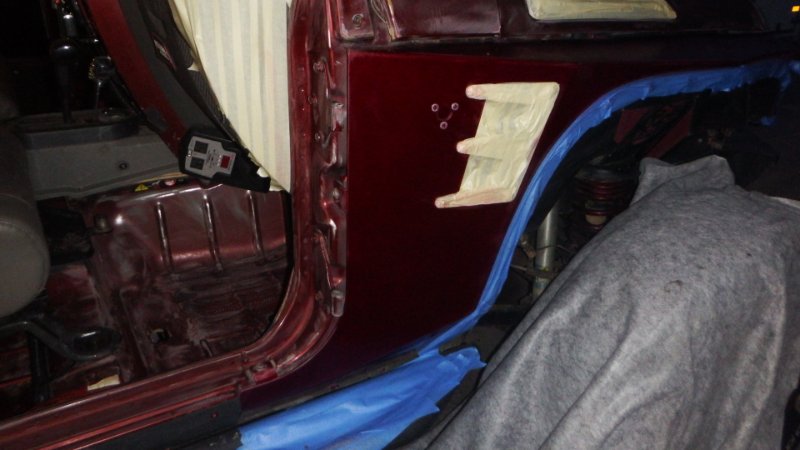

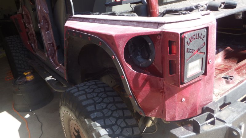

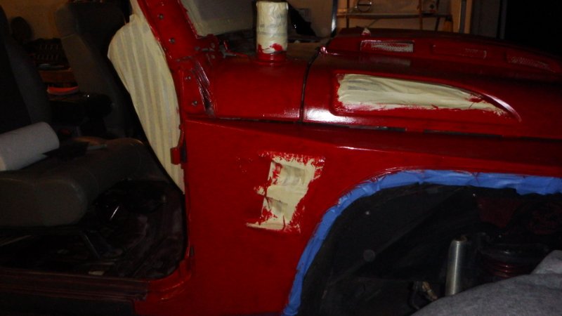

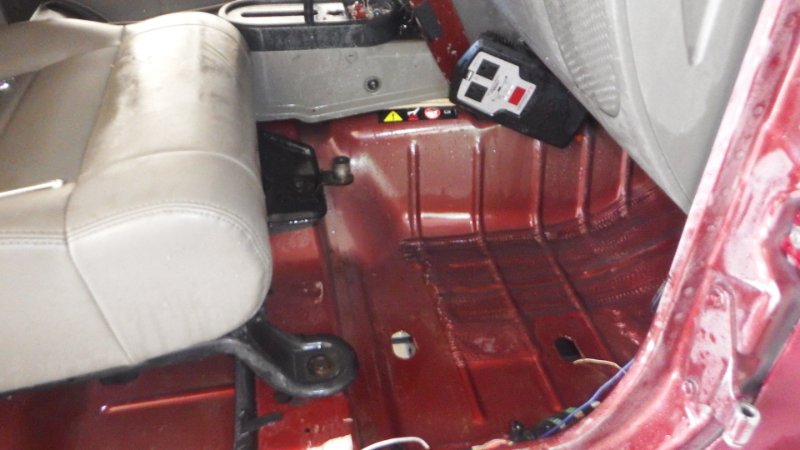

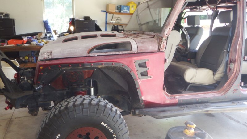

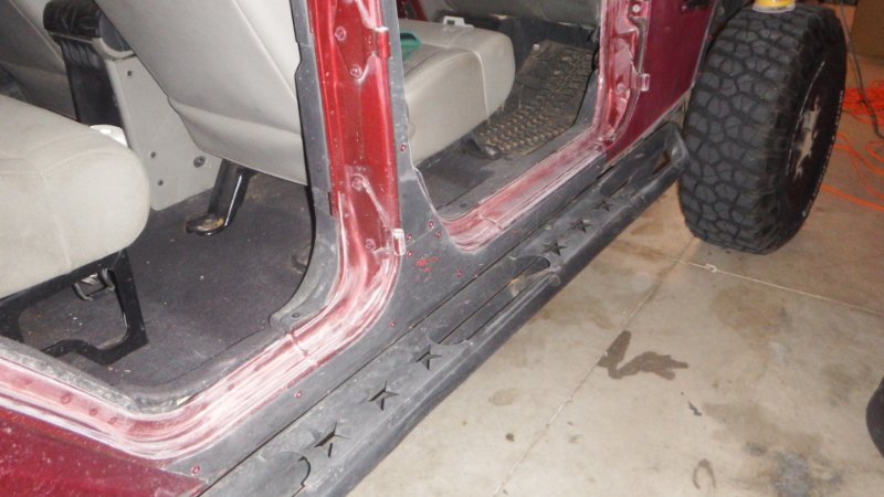

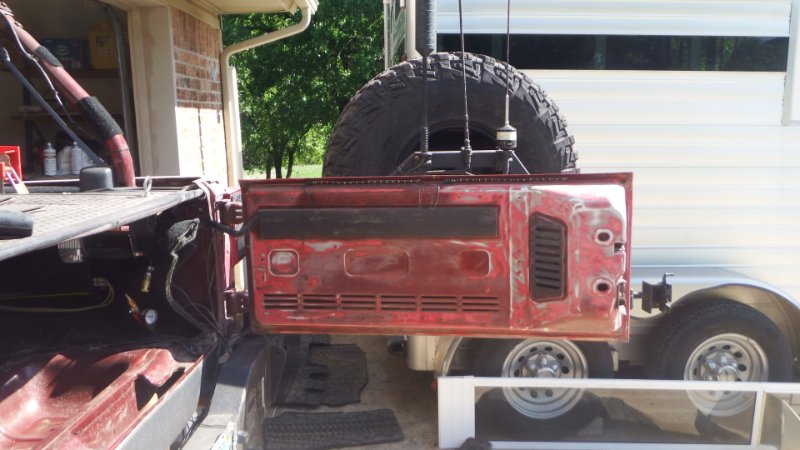

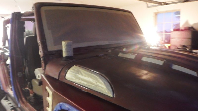

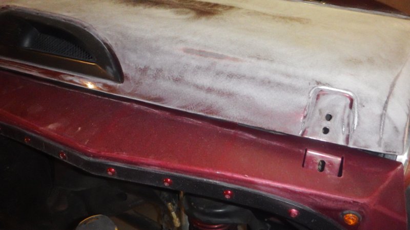

Next you Prep and no matter how much you do prep you will find many things you didnt even catch until the red glob is already there...or black in my case....
I prepped for four and 1/2 days and Ill be honest finally I said screw this I mean I could never stop... so Im gonna red neck the job because my fingers are killiing me I have been to the store now three times to buy Painters masking tape...to work with and IM tired plus it takes four to five days to fully cure you dont want rock chips and dents and bugs and guts in your paint job... even though the bugs wont really matter since they are biodegradable... as long as your cool seeing the antenna for that flying whatever for the next two yrs... 🙂

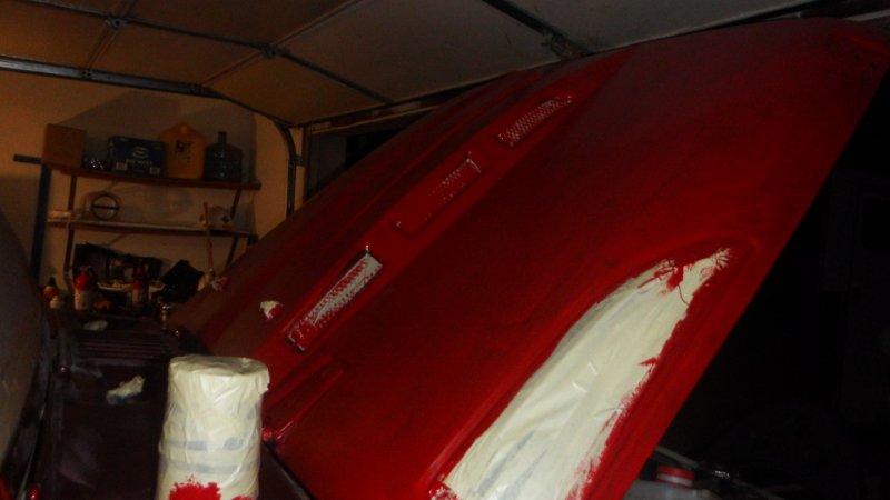

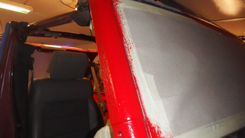

So you start to apply...when you do keep this in mind...

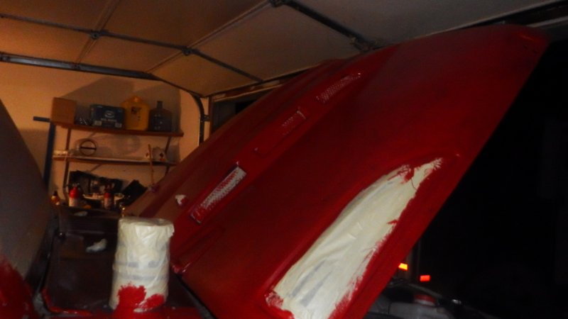

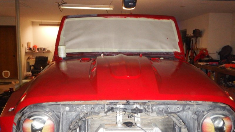

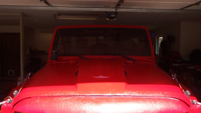

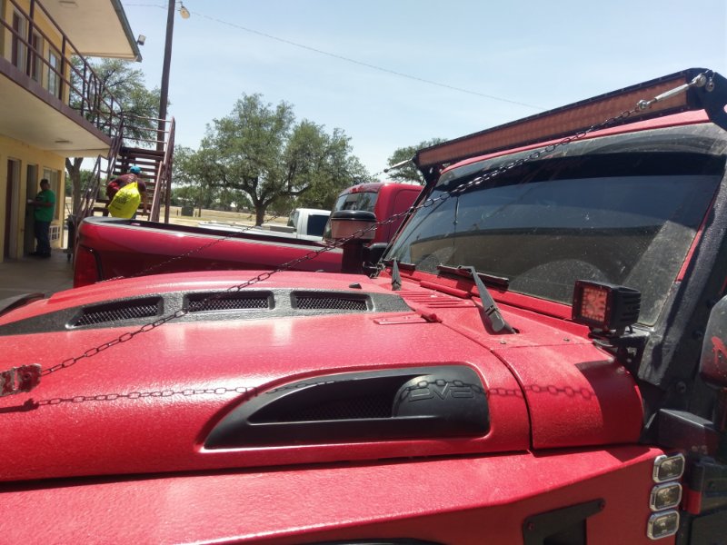

When you paint and get to much build up it will run...
Usually rattle can if you wait about 15-20 min to hit the same spot again it will hold and not sag or run on you...

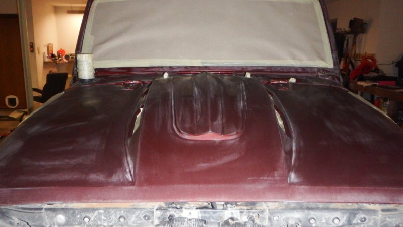

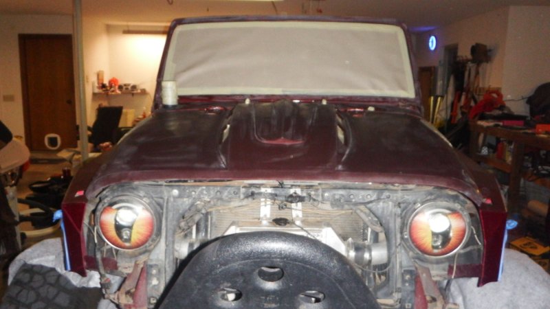

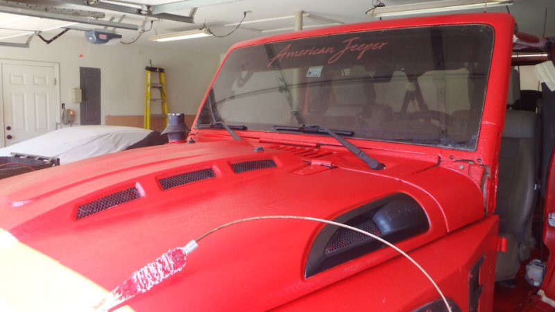

This stuff does the same thing for 8 hours... at least a solid 5 so when you do things like the hood move them every fifteen to 30 minutes to prevent sagging and runs...
Trust me if you can lay it flat do so and leave it be then you can grab most in a second coat touch up coat...
If your doing the underside of the hood work on getting the underside upwards angles first then the flat next... this way it will aid with some sode surface tension and will help keep the flats up until they start to get solid...
I did my hood three to four separate times due to this very thing... Pay attention and thin to win...remember make five coats but if you go thick and it drops on you or a sag starts to run your going to have to wait or wipe with mek immediately and feather the edge and wait then retry... then smooth all that crap out with third and forth coats...

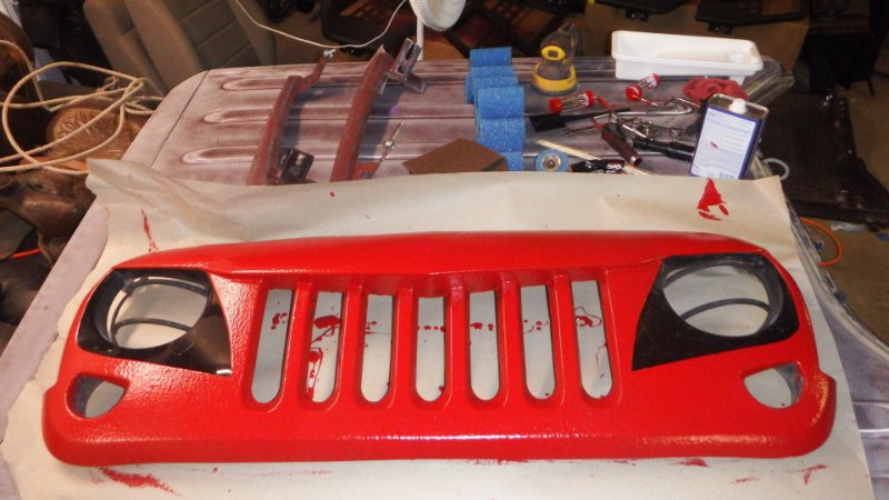

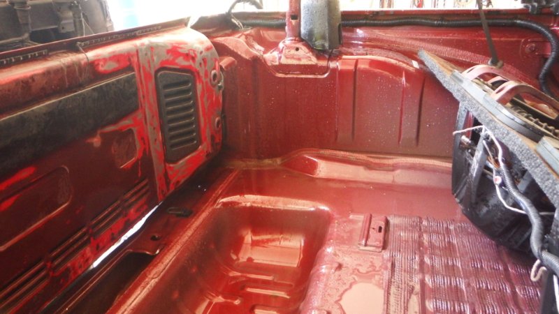

You will discover just like me that rather than using the blue Styrofoam rollers you may in fact realize that solvents eat That Styrofoam crap... and soon you will have a tiny sliver at the top sharp as glass strong as fiberglass and will get you and sand away you will for all your points that roller leaves a boat load as it starts to fail... and its due to also the amount of pressure you push down as to exactly how long until it def fails...
So I opted for a more material mini roller and found they lasted about 3 times as long and you will get the FEEL for it as you work on your whatever your Monsta lining...
More pics time...

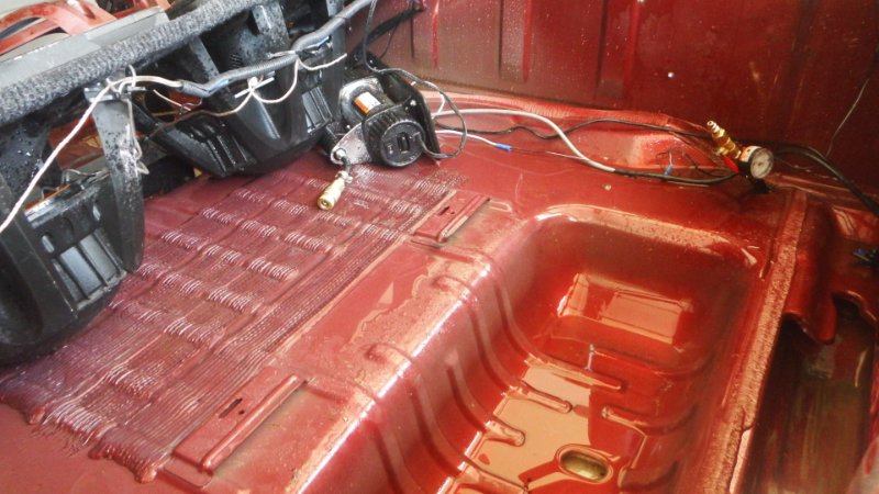

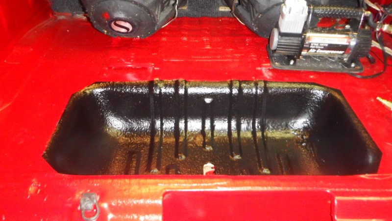

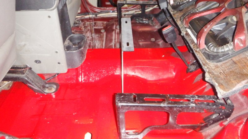

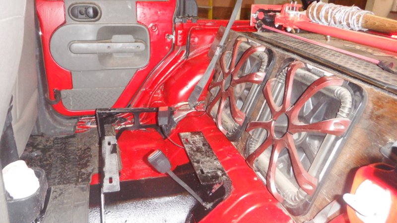

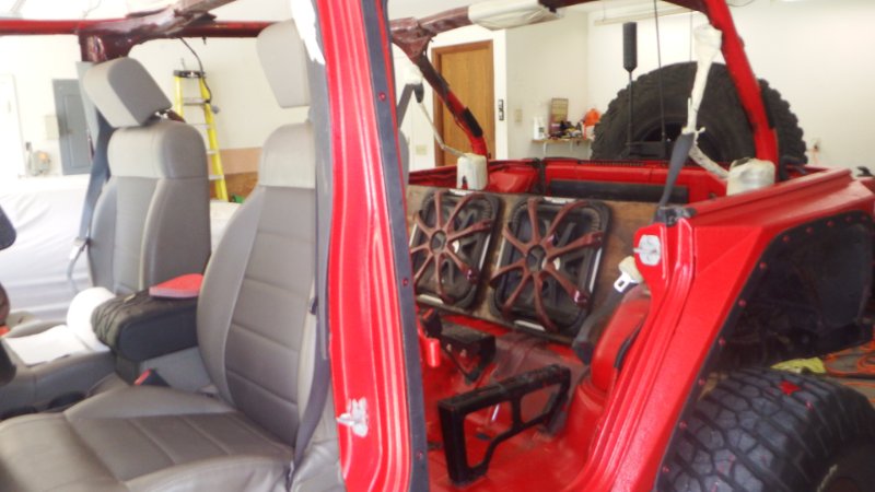

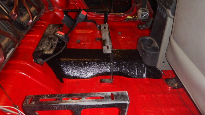

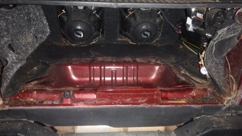

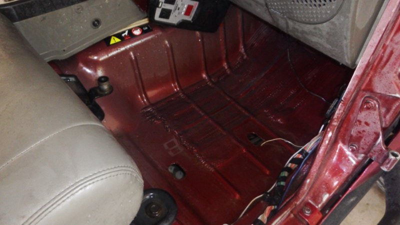

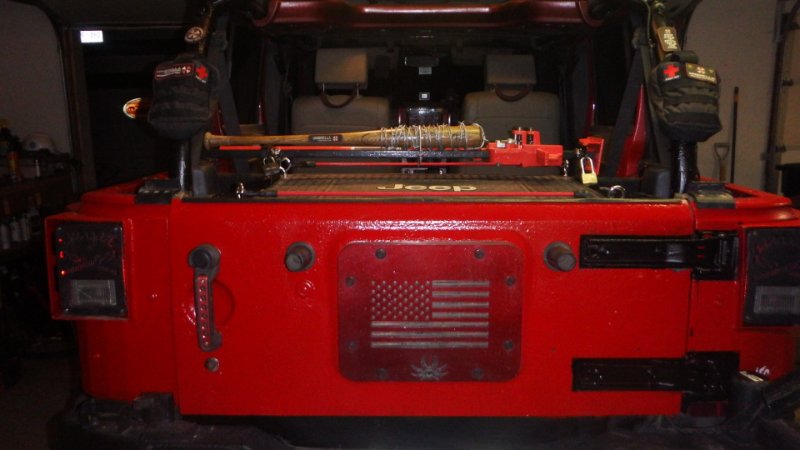

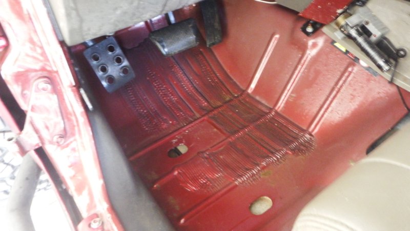

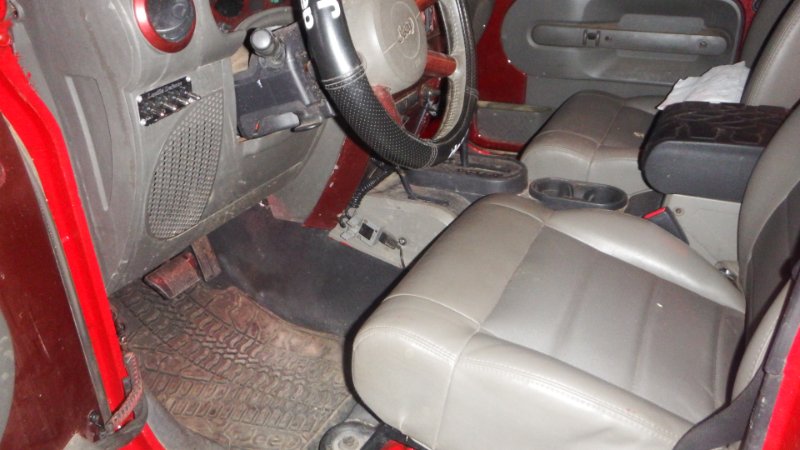

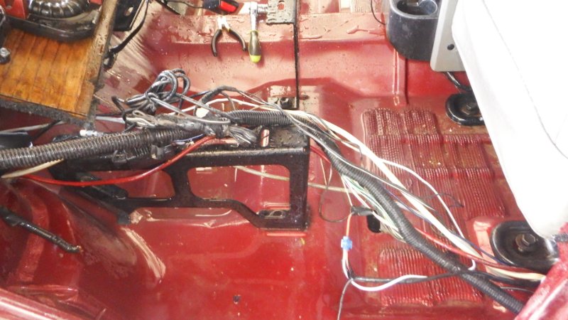

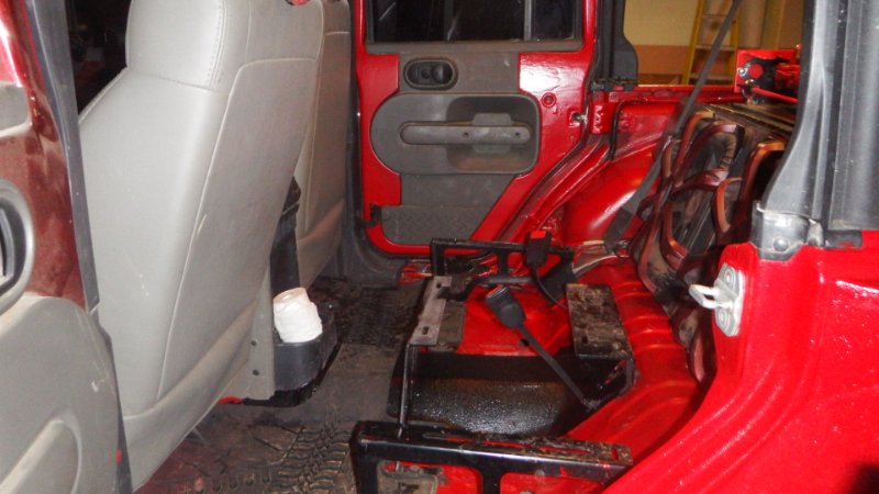

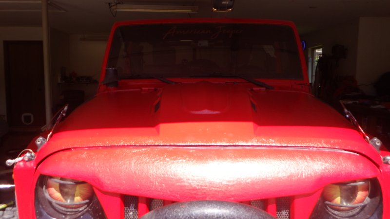

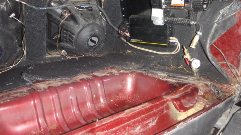

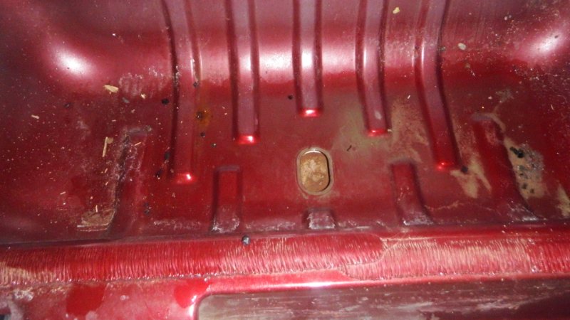

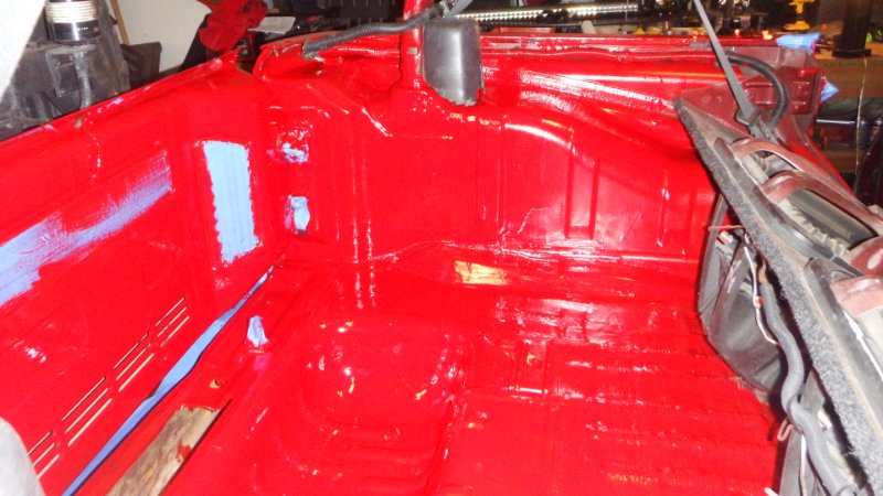

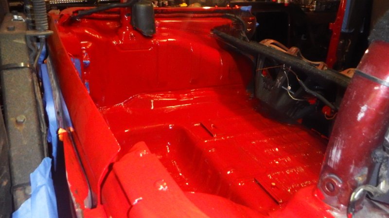

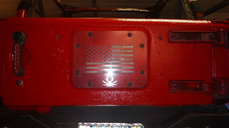

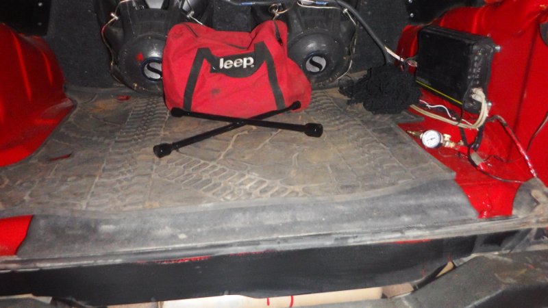

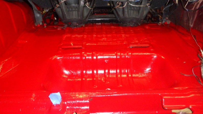

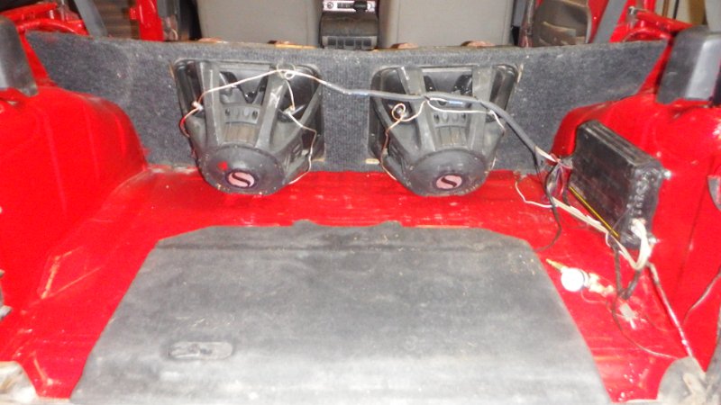

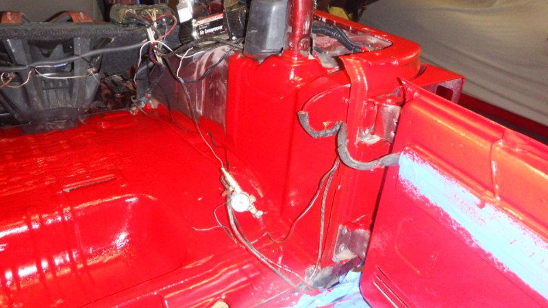

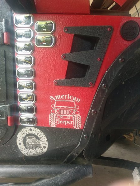

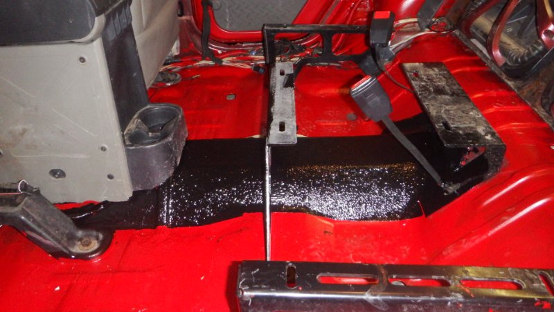

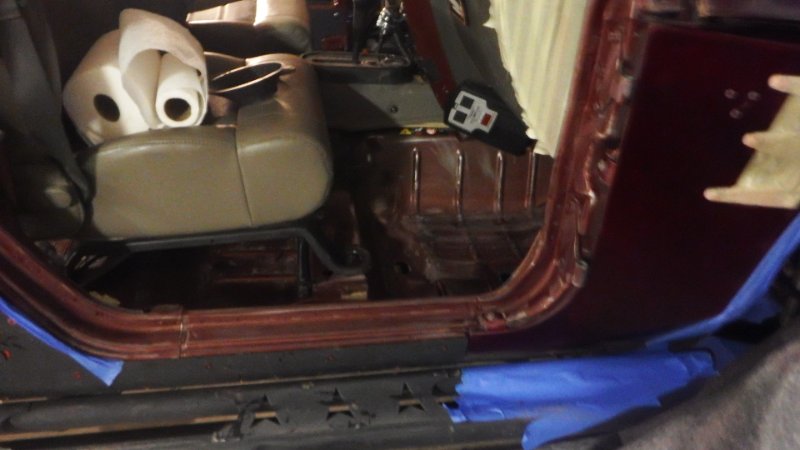

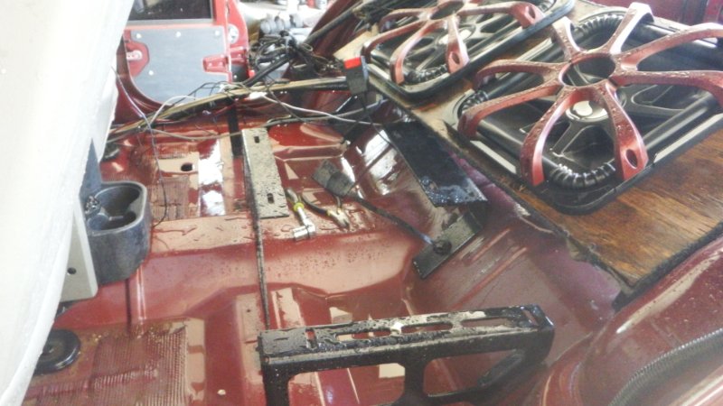

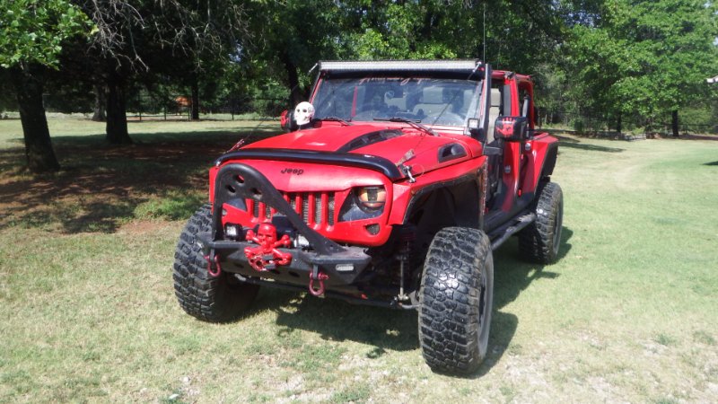

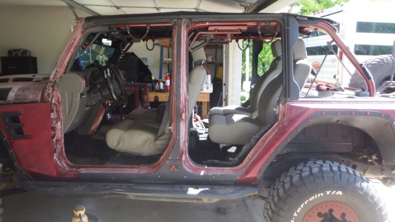

Ok I started in the trunk and on the floor boards and then door trims...

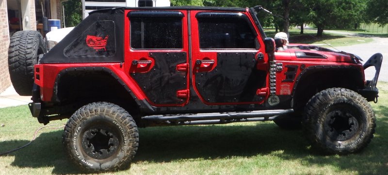

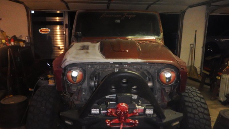

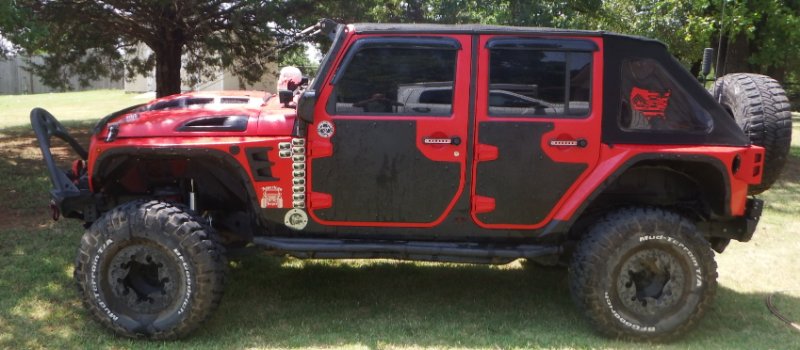

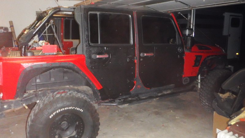

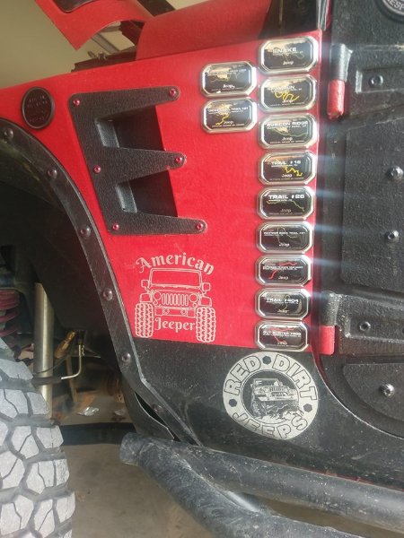

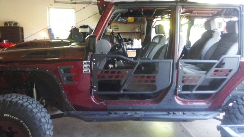

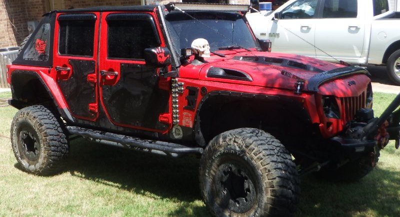

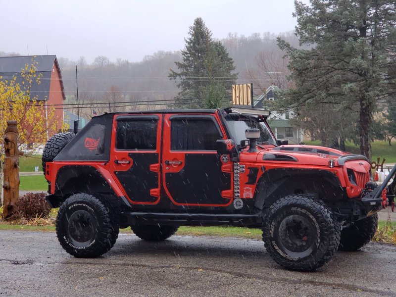

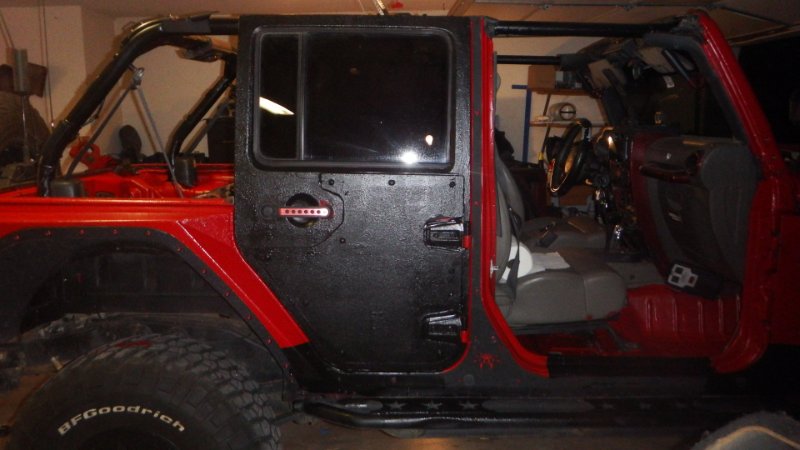

Then doors laying flat and I did them in red first then black then I panned on going red again then black a final time defining the doors but I got a call telling me to be on the jobsite in three days so I had to just let dry and drive like this for the next two months... soon to get completed mostly...

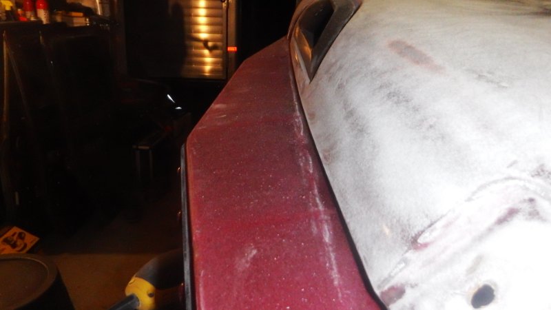

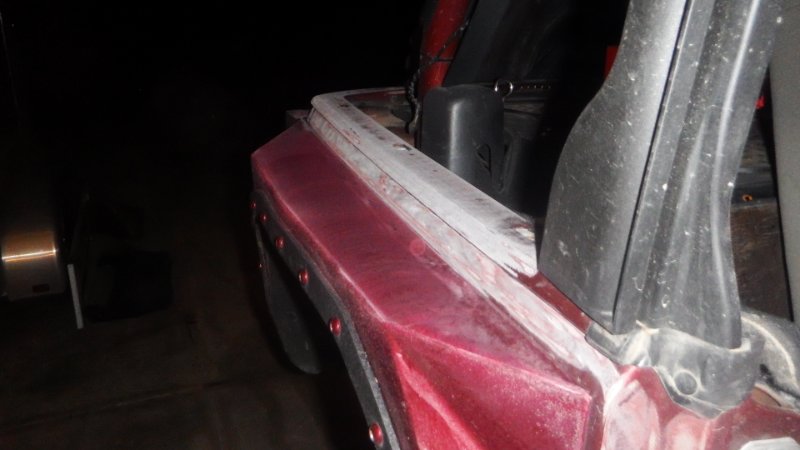

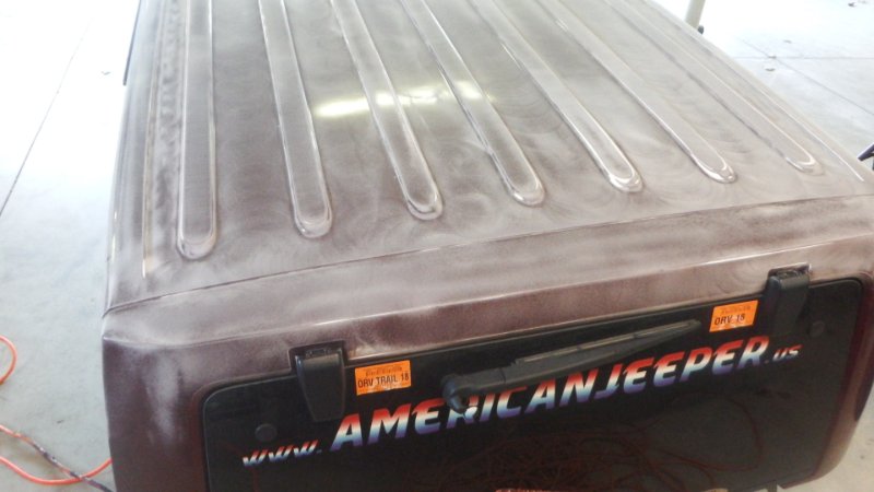

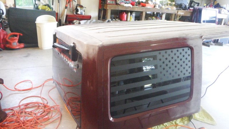

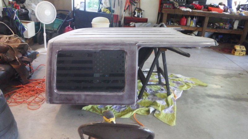

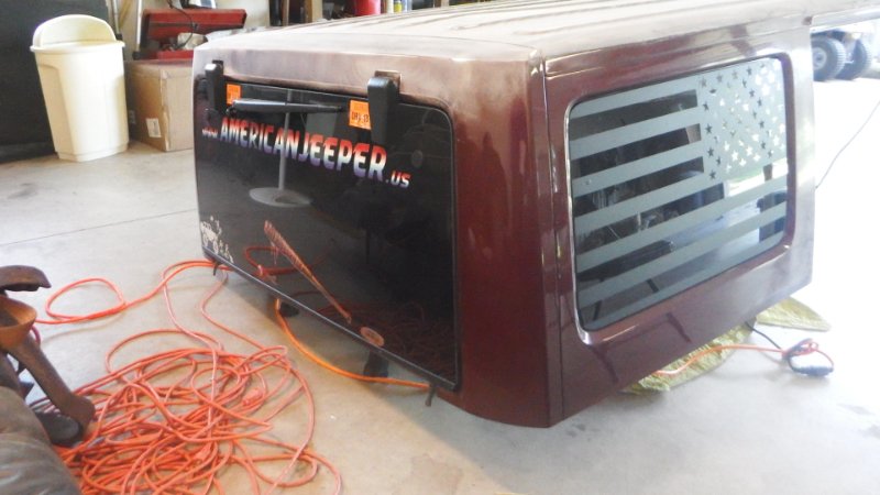

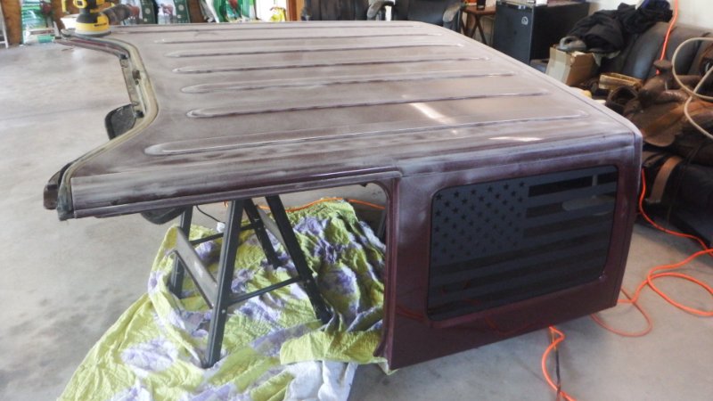

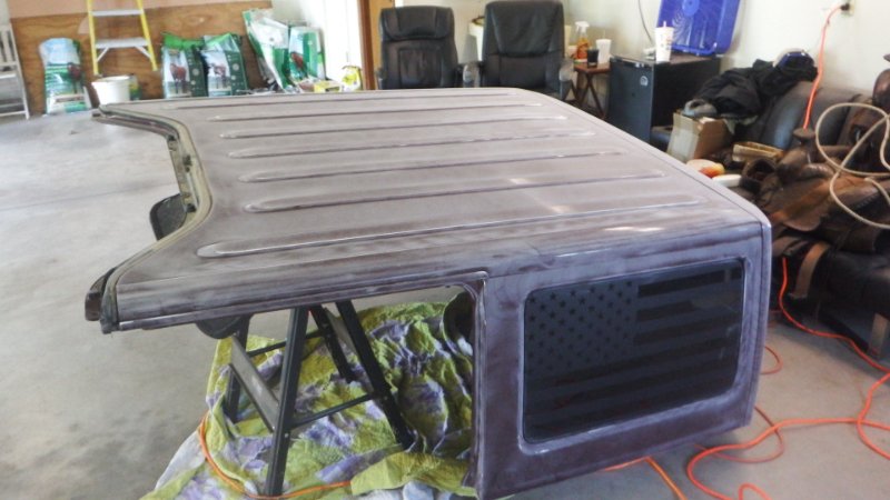

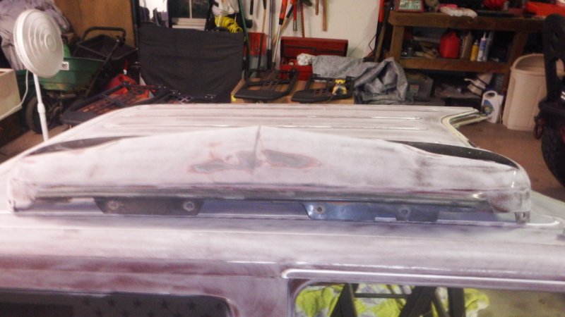

I started sanding the hardtop that same day I got the call to return to work, does it matter well now its half sanded in addition to not matching until that point I had 3200 in that hardtop and all so I should have started when I was positive I could complete, oh well work called so I jump...

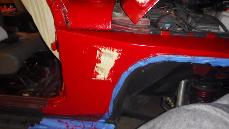

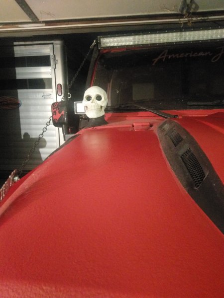

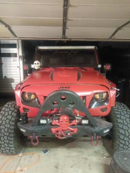

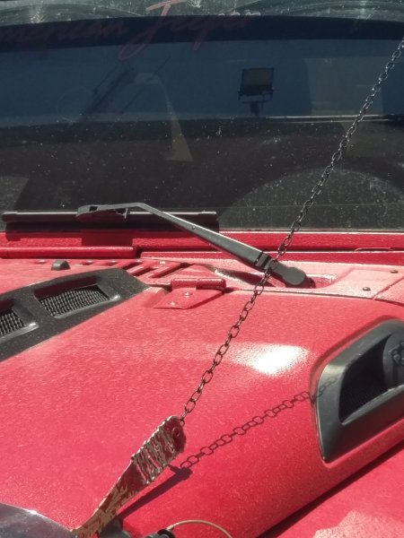

With correcting the proper roller and use in the technique of application cutting in and free handing and thinking so I dont mind a red mark on the bottom of the seat when I see it Ill still think well its a single stroke shit happens and I didnt have to remove those damn bolts and worse to get her done... 🙂

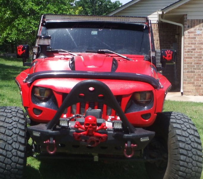

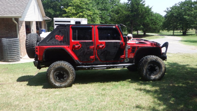

Finally I got two things a Day to finish the doors off better...
and sunshine...

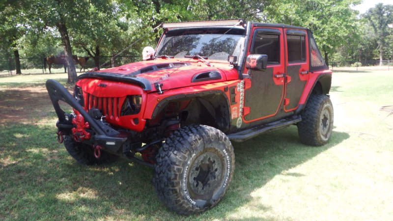

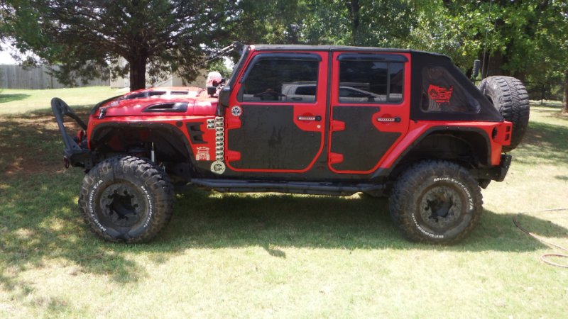

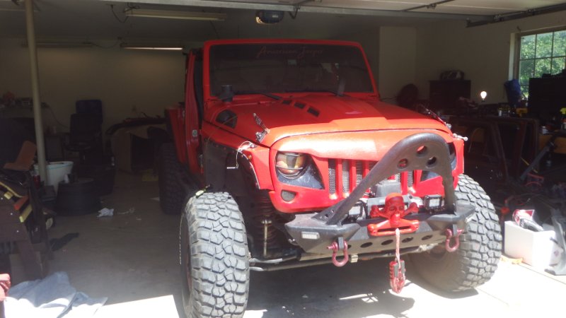

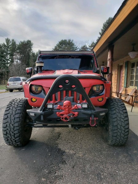

This is one of my Favorite Pavement shots of Lucille... 🙂
