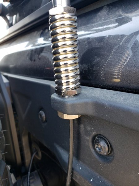

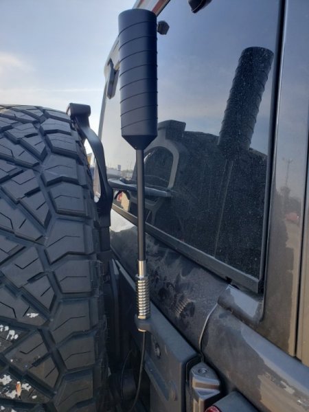

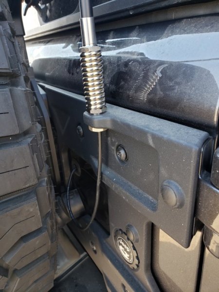

Pretty simple I mount up attached to the underside of the passenger back seat so its also higher than floor level in case of water or possible mud intrusion...
I then located it under the cell phone cradle on the dash... This provides Max reach fro what Im running... 🙂
1-3 bars added to what you already see... 🙂

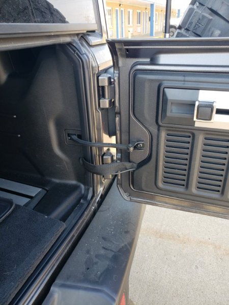

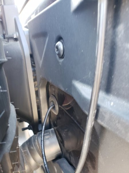

I routed the wires under the carpet passenger seat to the rear seat and under that then zip tie attached it to the coils under the read back right passenger seat along with enough slack the seat can be moved and folded flat without any damage to wires of the Unit...
