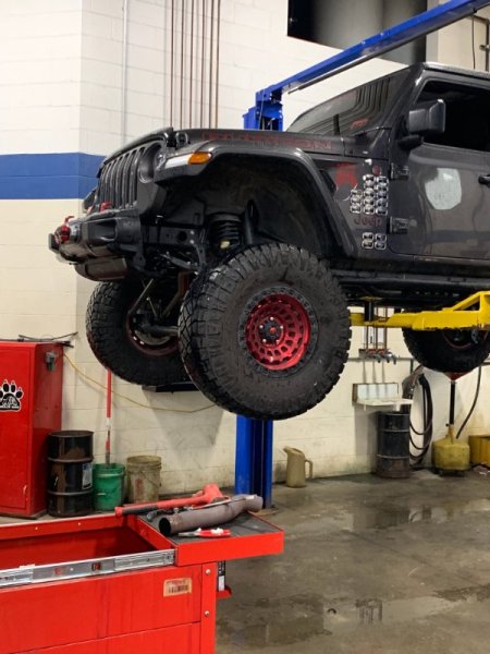

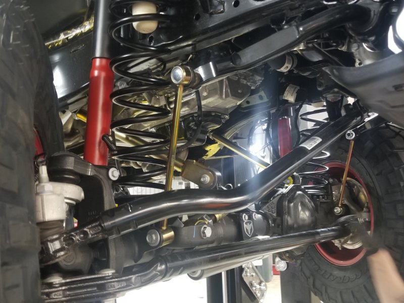

Metal Cloak 3.5" Progressive or Loaded Spring Set up Mid arm kit. JL
Suspension is Metal Cloak 3.5" Progressive or Loaded Spring Set up Mid arm kit.
No need for long arms on a JL...

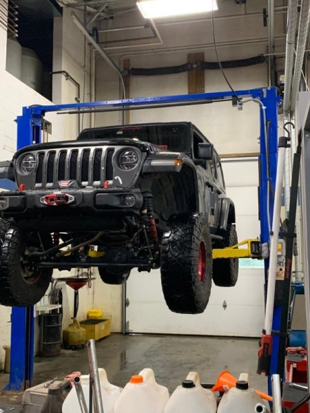

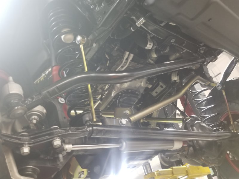

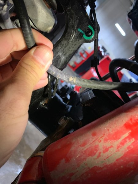

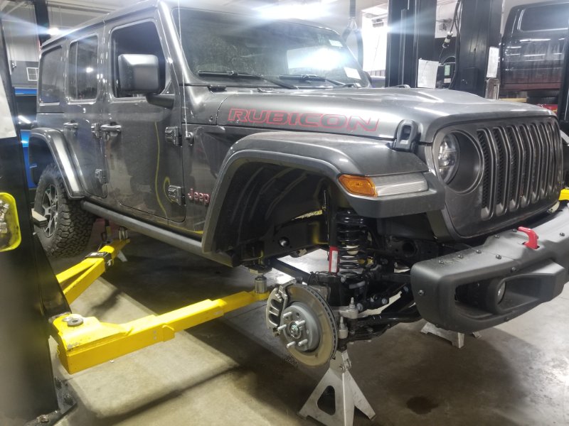

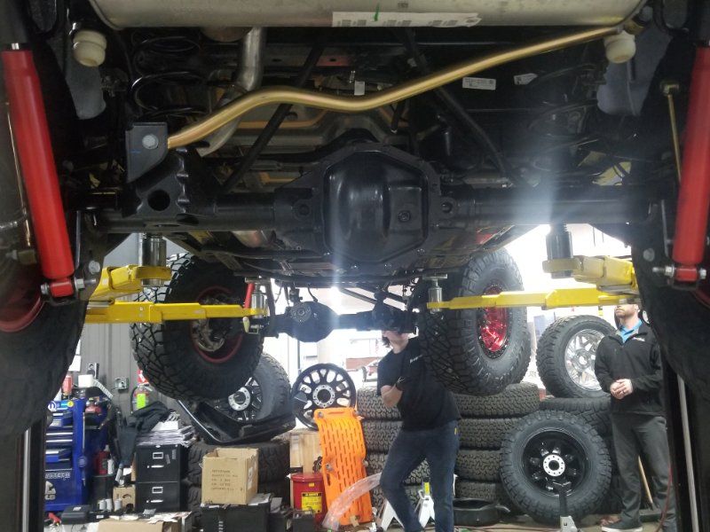

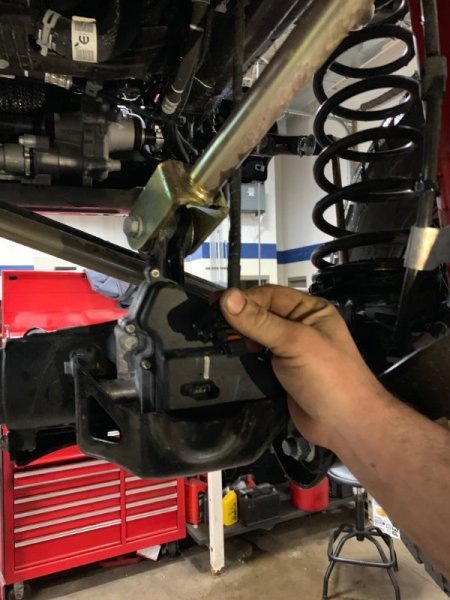

The rear Track bar was installed upside down... this was and has been corrected...
The dealer did the initial install and it required 1100 in repairs from another dealer to correct it all...
including nicked brake lines that could end worse than well...
I have stainless steel braided lines now 100 dollar mod and to me so much more worth it...
Also had to get a new 4 wd hub selector and add length to the wires about 8"-1'
The original dealer paid the bill...

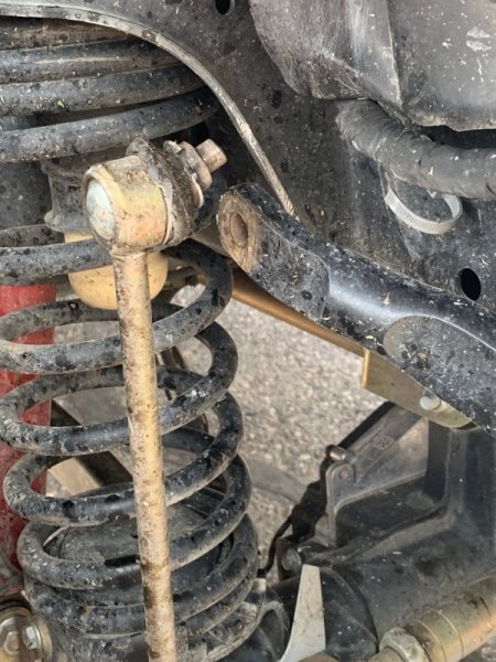

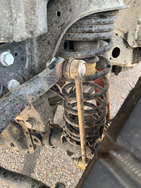

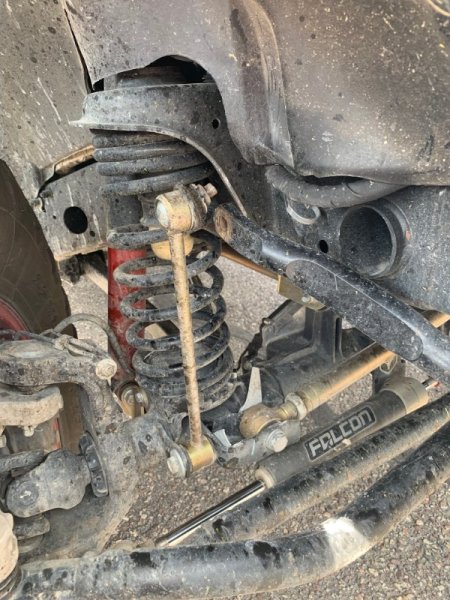

I did somehow manage to snap a Sway bar connect rod on passenger side so
Metal cloak sent me a set back so I had a spare just in case I needed to trouble shoot while I drove daily...
I thought that was pretty cool They said dont worry about it keep it and they hope I never need it...lol 🙂
