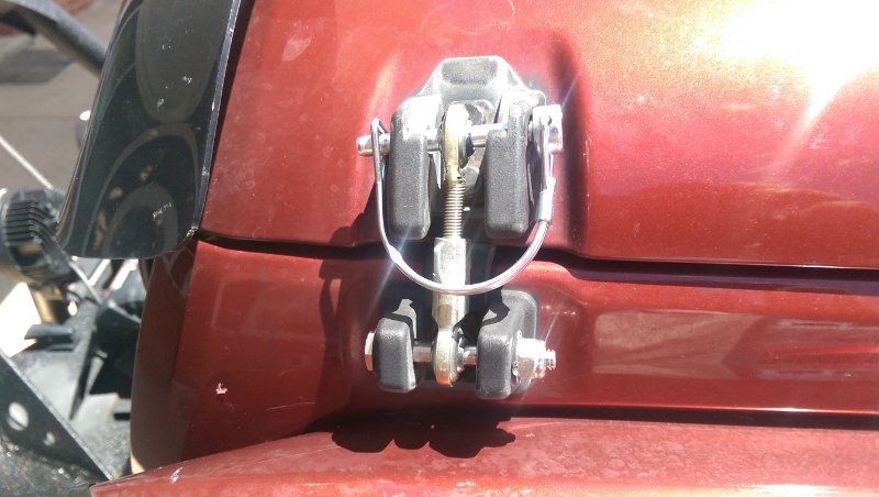

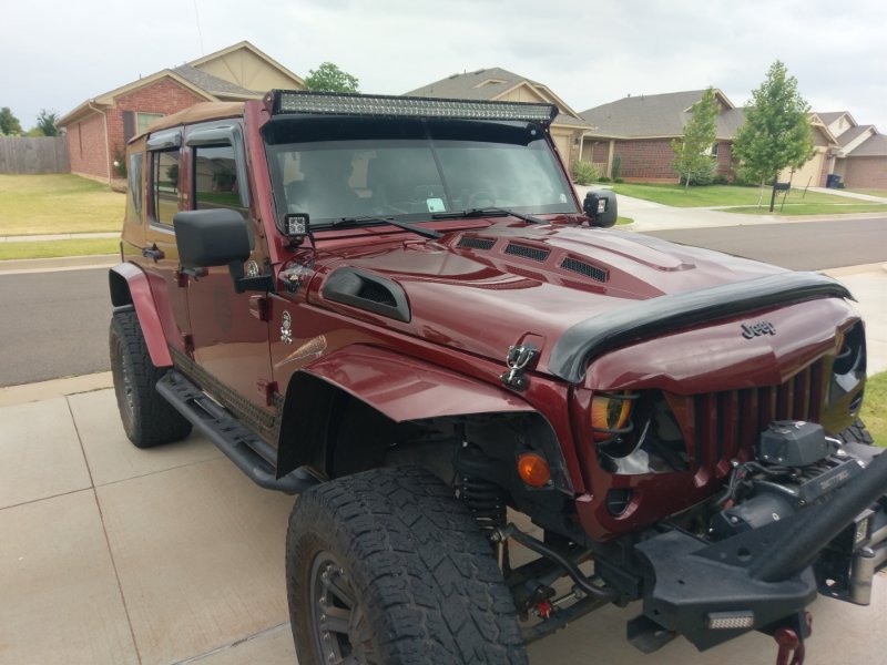

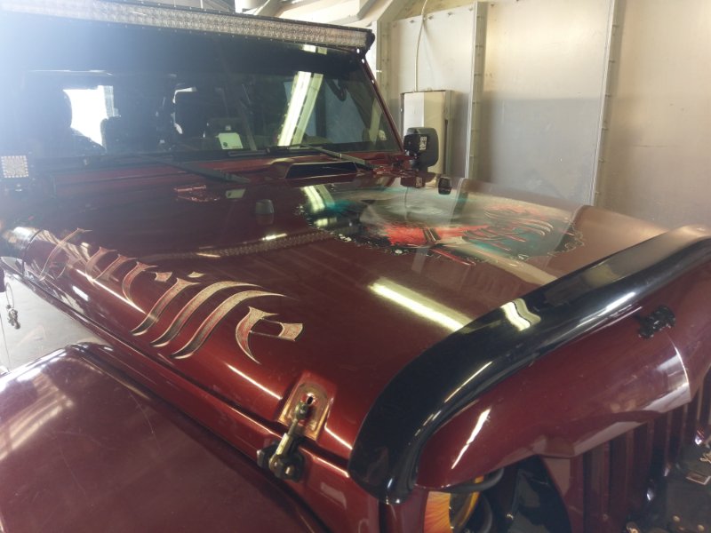

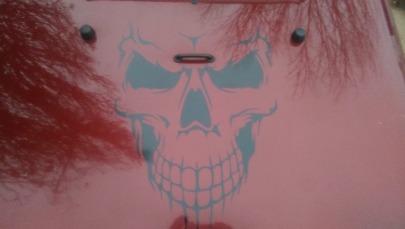

Making a set of solid latches can be as cheap as 25 bucks at the local ACE or Home depot or more depending on the parts you chose to use...
mine shown down there cost me right at about 30 bucks I think
Ive included a list... 🙂 enjoy...
Stop that annoying hood flutter for ever...
1/4 x 2" clevis lock pin
1/4 x 1/4-28 male right hand rod end
1/4 x 1/4-28 female right hand rod end
1/4-20 x 2" stainless bolt
1/4-20 stainless nylon lock nut
