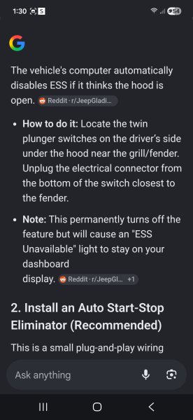

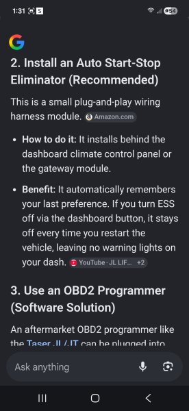

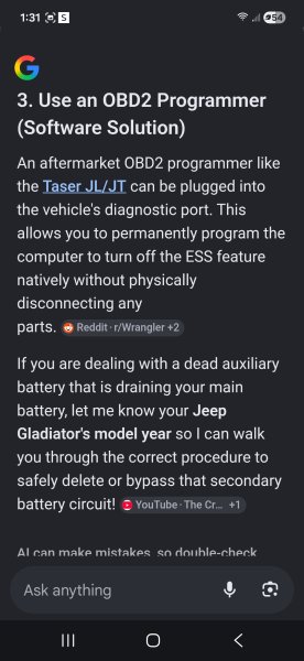

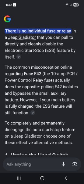

On another note 😁 I removed the fuse! Still the same. I don't want the start stop at all but 🤷 this is what I found about it. I would have a light on my dash if I disconnect the hood sensor! My ocd will not allow a light to on my dash 🤣
